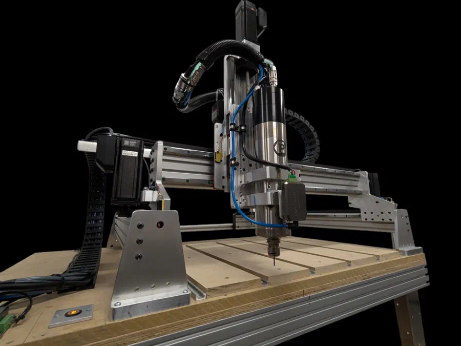

Rack-and-pinion CNC kit with non-GRBL electronics packages, five kit sizes
The Upshot Mill covers multiple kit sizes on one product page (2424, 4824, 4836, 4848, and 4896 in Easel’s menu; CNC4Newbie’s page also lists a 3636 size not in Easel’s menu). CNC4Newbie states a work area up to 50 x 98 in (max 68 x 110 in footprint, 8in clearance below the gantry) but does not publish a per-size breakdown table. It runs rack-and-pinion drive on X/Y and an HD ballscrew-driven Z axis with 8in of travel, 15mm square linear bearings on every axis, and can take a round- or square-body spindle up to 2.2kW, not included; mount options run from 65mm up to 89mm.
The Upshot Mill ships without a spindle, so its top RPM depends on whatever unit you mount, up to 2.2kW, check that unit’s own rating plate against the chart rather than assuming a number. Its rack-and-pinion X/Y drive, HD ballscrew-driven Z axis with 8in of travel, and 15mm square linear bearings on every axis are built for real rigidity. A truly rigid machine with a powerful spindle can cut as deep as the bit is wide in a single pass, but that takes real spindle torque, a drive train and clamps that hold firm, a gantry that will not flex, and enough mass to soak up vibration. With a suitable spindle mounted, the Upshot Mill can handle solid depth per pass, but still build up gradually. Push too deep and the bit deflects and chatters, leaving scalloped edges, or it rubs instead of cutting and burns the material. The fastest way to dial in a cut is to see what has already worked for other people.
