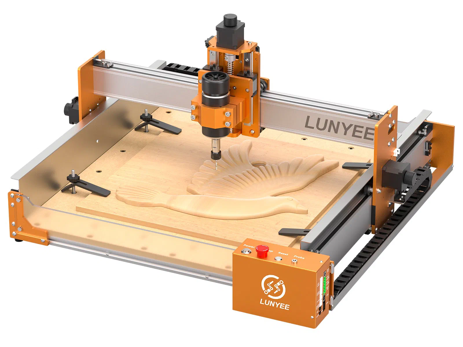

Compact CNC router with a 100W spindle and a ball-screw Z-axis
The 4040 Pro is a compact all-metal CNC router with a 400 x 400 x 90 mm working area, a 100W spindle (0 to 10,000 RPM), and Nema 17 stepper motors (1.68 A, 0.55 Nm torque). Its Z-axis rides on dual HG15 linear guides with a 1204 ball screw.
The 4040 Pro’s 100W spindle tops out at 10,000 RPM, below most of the chart, and it has the least power of Lunyee’s router lineup. A small spindle like this loses torque fast under load, so leave it near its top speed for everything and control the cut with feed rate. Depth per pass is where the machine itself matters. A truly rigid machine with a powerful spindle can cut as deep as the bit is wide in a single pass, but that takes real spindle torque, a drive train and clamps that hold firm, a gantry that will not flex, and enough mass to soak up vibration. This machine falls well short of that bar, so keep passes shallow: push too deep and the bit deflects and chatters, leaving scalloped edges, or it rubs instead of cutting and burns the material. The fastest way to dial in a cut is to see what has already worked for other people.
Worked example for feed rate: 1/8in (3.175mm) two-flute solid carbide end mill in hard wood. The chart says 16,000 RPM. With the bit maker’s 0.025mm per tooth (0.0010 in): 16,000 x 0.025 x 2 = 800 mm/min (31 in/min) feed. For depth per pass, start shallow and check Community Cut Settings in Easel for what works on the Lunyee 4040 Pro. If the cut sounds strained, reduce the depth, not the feed. Slowing the feed below the chip load makes the bit rub instead of cut.
