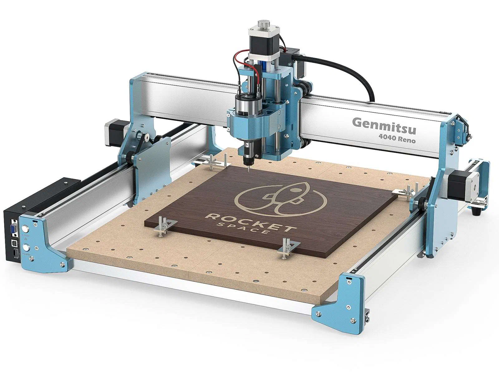

About the Machine
The Genmitsu 4040 RENO has a 400 x 400 x 76 mm working area, a 75W spindle (upgradable), and NEMA17 stepper motors on a belt-driven X/Y with lead screw Z, using a dual Y-axis and two-stage Z-axis design.
